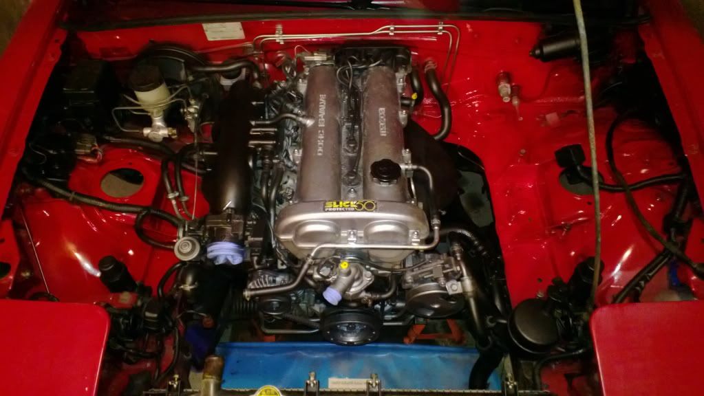

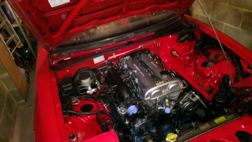

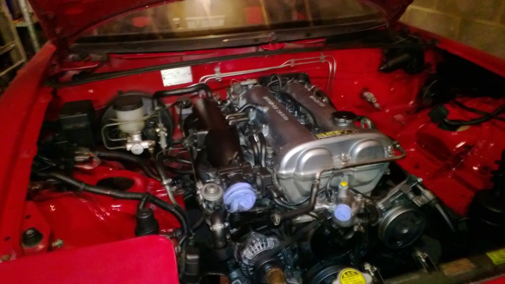

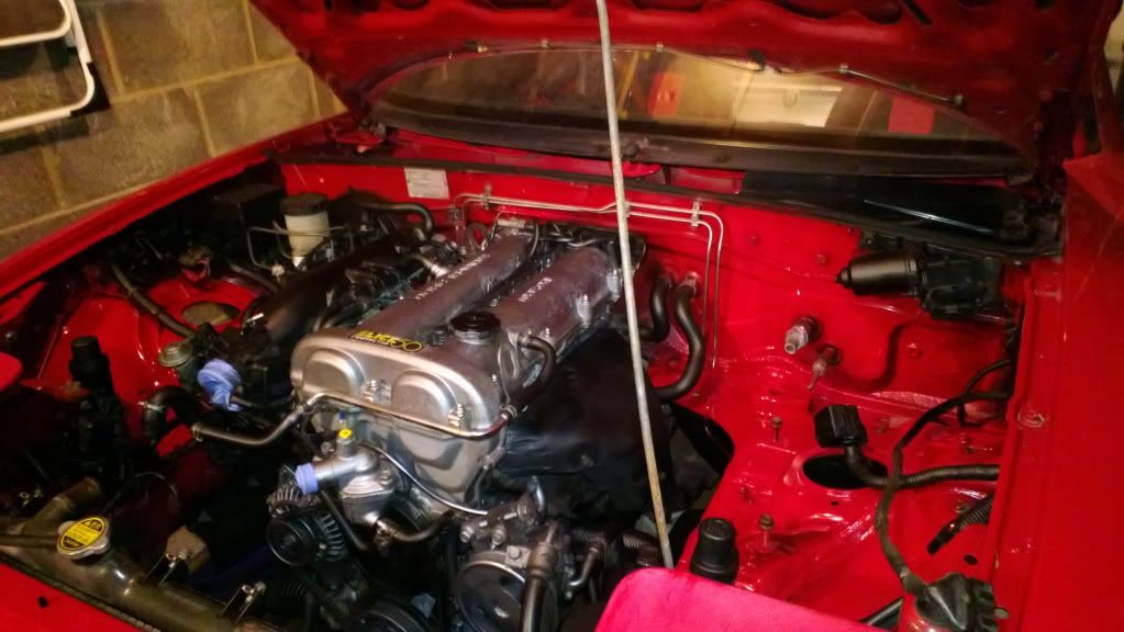

Well, today I took the engine area apart again... and finished it properly :) refurbed loads of bits, fans, bottles, coil pack, inlet, air box, pipes, polished bolts, fitted my gold cam cover, cleaned properly the ht leads...had a fantastic day fettling with this. Really enjoyed myself... got a bad back now though..
So it now looks like this (strut brace not fitted but in place just to see what it looks like :)
Also went through all the paperwork that came with the car.... found the receipt for the timing belt and water pump kit which was done only 5km ago last year :) WHooppee...saves me a job.
