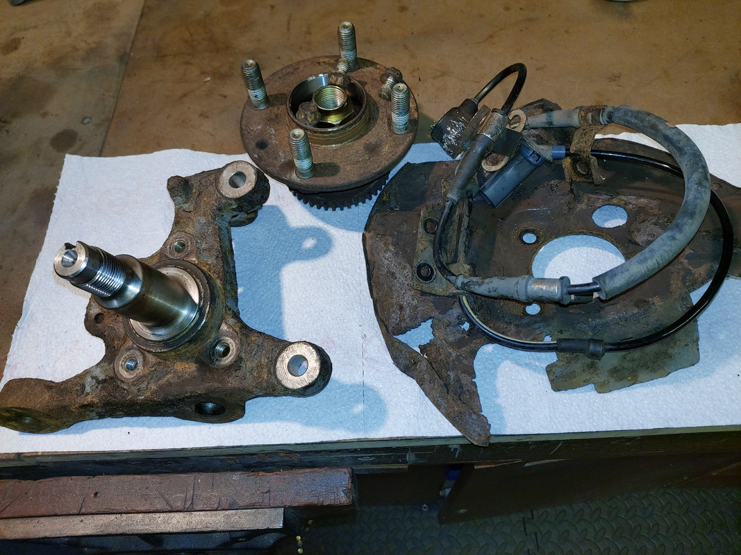

In between treating the garden fence panels, a start has been made and as promised a few photos.
I unpacked the two s/hand front hubs and they are the usual rusty collection of bits.
Next I started to dismantle one hub, getting the dust cap off was the first obstacle as it looked fairly new and I was keen to not damage it, the nut followed and I immediately discovered why this is easier when it is all attached to the car.
Nut off and I withdrew the hub which I may reuse as it appears to be in good condition, the three brake shield bolts needed some release fluid but finally came free with a breaker bar.
The bottom ball joint needed the large separator but I finally had a collection of parts.
Well almost as this donor vehicle had ABS so the sensor also needed removing, how you do this on the car I can only imagine!
The hub has the toothed ring and I would be interested to know if this is removable or do I just leave it be?
The upright was next introduced to the wire brush on the angle grinder and finally coated in Deox rust remover and left in a sealed plastic bag overnight.
All for now, more to follow.
Leave it be, it is for the ABS sensor pick up,will not give any uses to not change them bud.

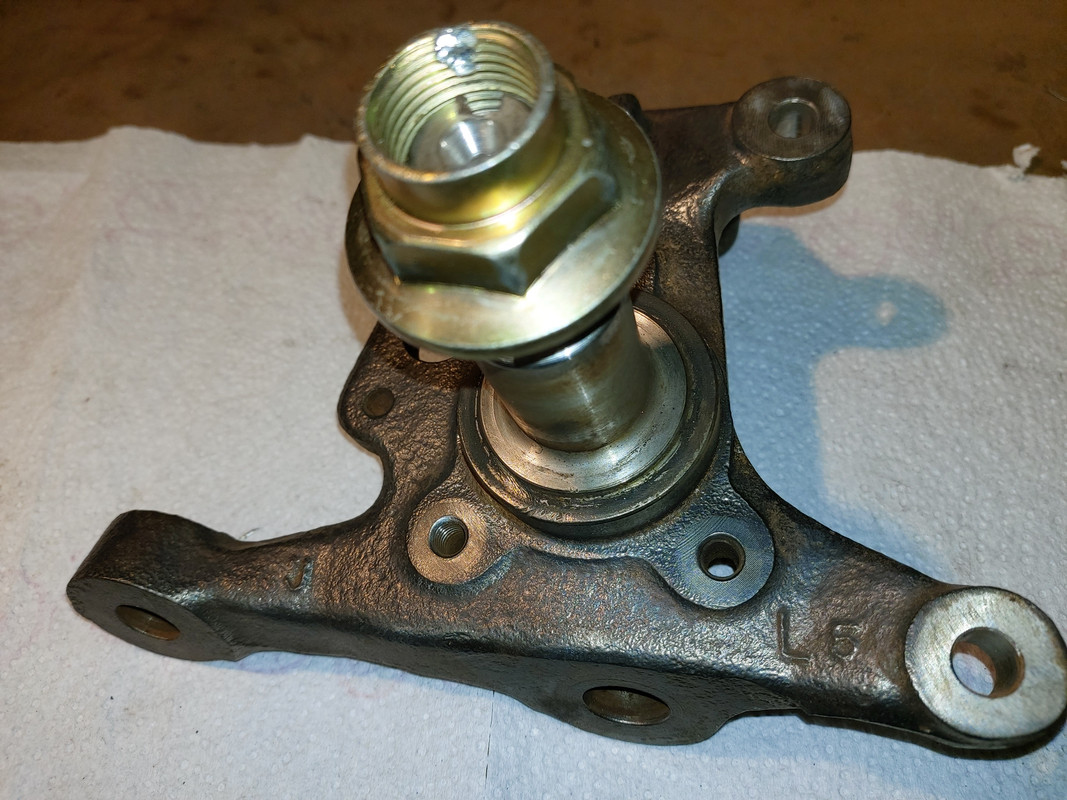

So as start was made on painting the Mk2 parts, the upright is sound and now looks resplendent in a coat of red oxide primer and because the hub bearings appear to be ok this has been similarly sprayed.

Progress is slow, thanks to the weather but the uprights are now painted and the hub/bearings sorted however the search for newish brake shields has proved pointless in this country. I will probably be able to reclaim the exiting units but this will take time and I am trying to minimise the down time by having everything ready to bolt back on.
Having sourced the correct size 29mm socket I note from the manual that to preload the bearings on assembly a torque of 123 - 159 ft/lbs is required, this is beyond my present torque wrench so the source is on for an affordable one. Would be interested to know why such a range and more importantly what figure I am aiming for?
