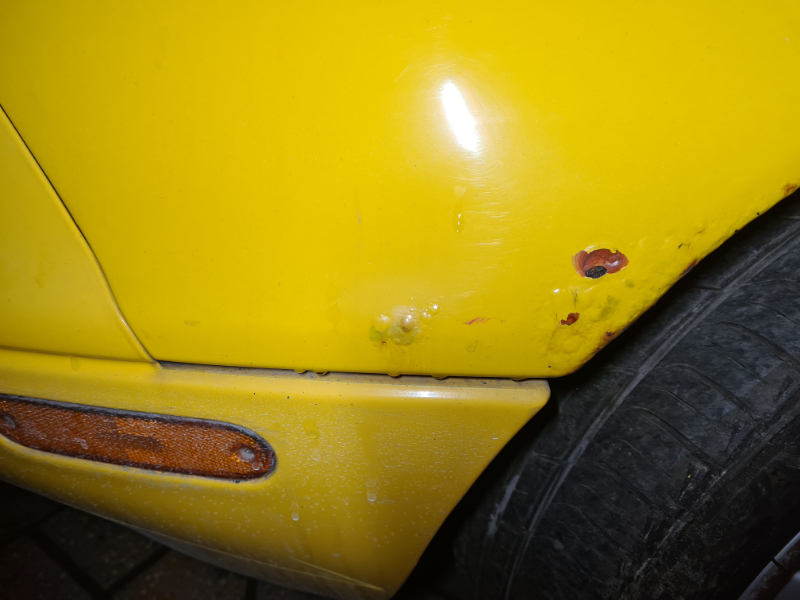

Posts: 15331
Location: Pie land, in the glen of Wiganshire
Re: Build 15 The poorly J LTD needing some magic hands
Postby Mazda Mender » Mon Feb 14, 2022 8:10 am
Well what a crap weekend weather wise....
As is always the case , if there here , i'll do something that's needed on them...
There was a couple of things in my head to sort before she goes off to Rotland with Andy , so in-between rain showers and guests calling for a chat etc, the main thing of securing a fresher soft top on for the minute could not happen yet because of the showers so at least i managed to hit a few things off the ever growing list....
So mainly on sat after the hospital appointment...
I sorted the boot brake light wires,
Removed the crappy aerial stub and shoved in a grommet for the time being
Removed a live wire running from the battery to under the passenger seat?
Wire in the rear fog light to the rear cluster.
Fitted the rear fog light switch
Removed the immobiliser and made wiring good again
Fabricated the bonnet lock up for the time being with a newer lock so the bonnet stays shut.
Aligned the passenger head light light ( OCD moment)
Jizza Cleaned the engine bay ready for when she comes back.
Found some of the missing trim bits,
Jizza cleaned the rims.
Found a battery tray and J bolt ( just need to find a clamp)
Found a HRW rocker switch,
Battery on charge
Isolater switch ready to fit
Found a spare hood on the frame ready to fit for the time being
Banged some rear deck mushroom bolts on to secure the HT for the minute.
John arrived with some bounty in the boot that could be used on her?
Sunday late on after a road trim with Mr Carl Stuart, ( sourced a newer bottom screen cowl and screen frame seal) removed the remains of the roof , brackets , rain rail and pitch bolts .
That rain as never kept water out from day one of who ever fitted ( tried) the MK 2 skin to the MK 1 frame, it was really bad, and goes a long way in it ending up doing the complete opposite to what it was meant to of been fitted for in the first place and explains the condition of the sills and arches as the stored water from the ill fitted roof
Found newer brackets and MK 2 side brackets ready to fit the frame and hood.
