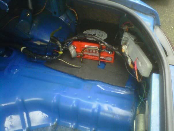

finally found the pic hidden in the depths of my facebook here it is :)
I remember the days when ‘Blue Ray’ was an elderly gentleman who drowned in our local swimming pool.
Re: What's killing my batteries?
Interesting stuff mate. What battery is that and do you have any problems with it at all?
Do you think it would be up to running a Mk2.5 with a standalone ecu running piggy-bank, 300W amp, AC, etc. that doesn't get used enough, lives in a garage and occasionally needs a bit of cranking to get it started?

the one i had i would probably not reccomend running a sound system on it as its generally used to start the car and thats it , if your running amps etc... you will need a heavier duty battery sorry for the late reply :)
